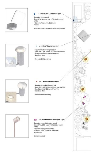

I’ve copied/pasted some images from the web onto a sheet in Layout. These images were fine through several versions and saves, but then one day they weren’t, and had turned semi-opaque. I deleted the images and re-pasted them into the sheet and they were in full colour again, until now - it’s happened again. Strangely its just 1 sheet in my project, the other sheet of pasted images is fine. I could delete and re-paste the images as before, but I’d just like to know what I’m doing wrong. Attached image shows the web lighting pics, inside a rectangle drawn in Layout - you can see my text boxes and model colours are fine. Many thanks!

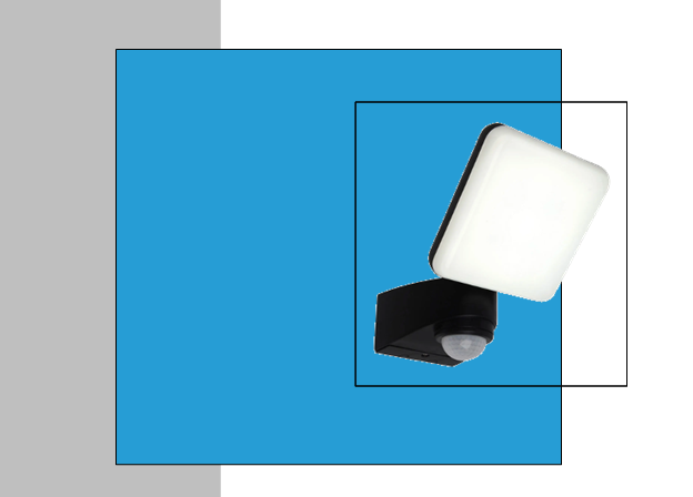

So the images I see, while they are .png files have white backgrounds. Easy enough to fix if you’ve set a default image editor in LayOut’s Preferences>Applications. Then you can right click on the image and choose Open with… Make the background transparent, save the changes, and then go back to LayOut. Here I put a blue rectangle under part of the image after editing it.
Here the images with the white backgrounds all have transparent backgrounds.
