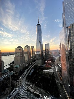

I think if everyone came together and agreed on everything then it is possible. However, there will be many stakeholders and everyone will want to have their voice heard and their input considered. Look how long it took to rebuild the World Trade Center in New York. The issue was not so much the construction as trying to get everyone on the same page.
Realistically it will probably take three to four years just to sort out what should, could and will be done, from that point it will be another 1-3 years for actual construction.
there is obviously no possible comparison with the WTC, which was totally destroyed, for a start.
True, the magnitude of the damage/disaster is considerably less, so hopefully the time taken to determine what best course of action to take is proportional to the situation. Only time will tell.
