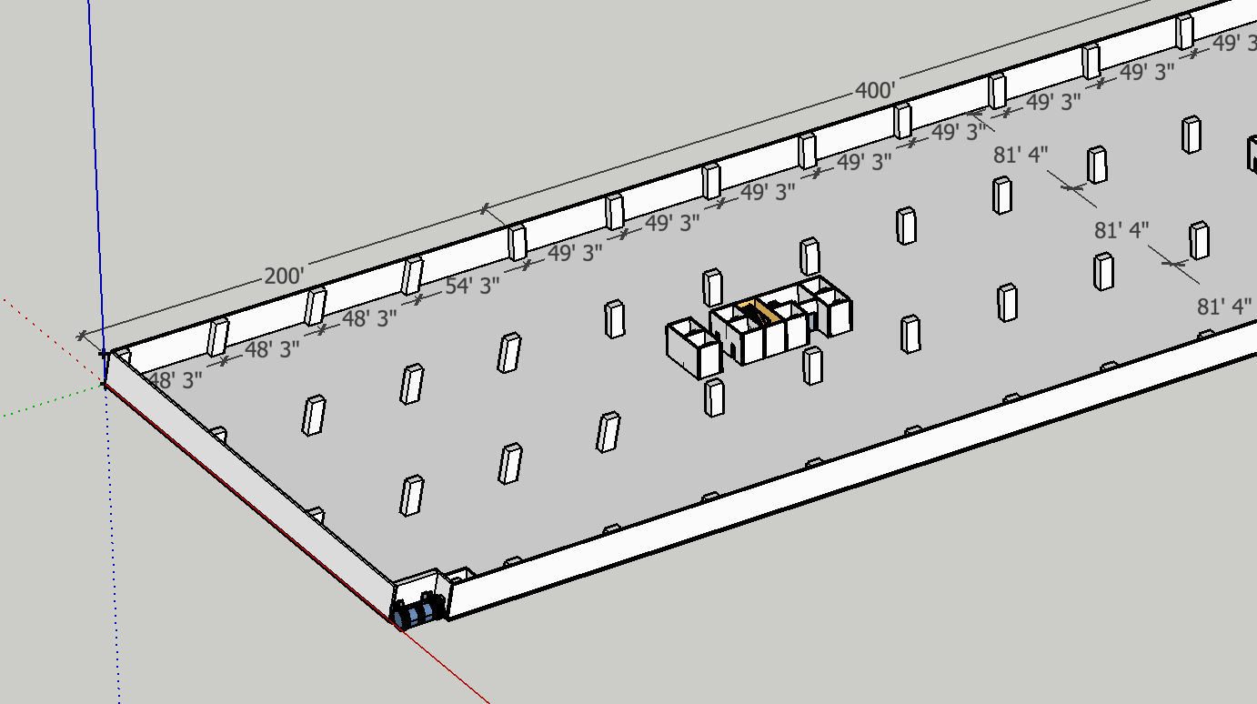

Here’s an image of the half nearer to the origin.
As before, dimensions are all on a layer Dims. Turn off or delete when you want not to see them.
I can’t find your extending canopy, so have drawn a simple block approximation of it.
If you have a copy of all of your earlier version, you could I think safely purge this one.
Haven’t looked at all at the central halls and inner elevators - just concentrated on getting walls, floor and columns clean and accurately drawn and located.
I have made 7 rows of upright columns - three each side mirrored, and one central row. That’s as close to 50’ separation as i could get. Eight gives awkward division by nine spaces, and gets them too close.
