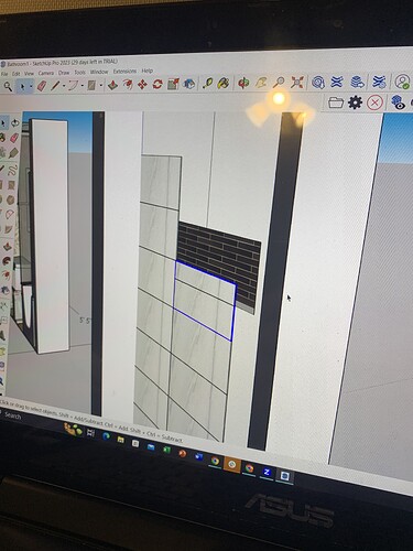

Hey guys. Glad to meet you all. Second day using Sketchup and having a blast but am stuck. Creating a bathroom remodel design. In the tile shower there is a niche. I took the tile (already a component) from the floor and copied up it a few times until I got here where it needs to be trimmed around the opening. Made it unique to try drawing a line and erasing the overlap but no luck. It’s simple, I just can’t figure it out. Thanks
Right click on the tile component and choose Make Unique. Then double click on it with the Select tool to open it for editing. Trace out the part you want to cut away with the Line or Rectangle tool (your choice). Then Push/Pull to eliminated the waste.
BTW, please correct your forum profile. It says you are usinng SketchUp Free which is web based. Your image shows you are using the desktop version though. That information, when it is correct, helps us help you.
Sounds good, I will try this in the am and update you. Thanks. Profile updated

I appreciate that fellas. I’ve been using YouTube so far but will watch the campus videos. When I got into this I just wanted a design for a new bathroom lol. Which is still my only goal for now. Last thing I thought would be using a cad software. Little do I know this is super enjoyable and maybe something I would pursue to a deeper level who knows.
Anyways, with the help, very easily got past where I was stuck and made good progress. Let’s see how this turns out in the end.
