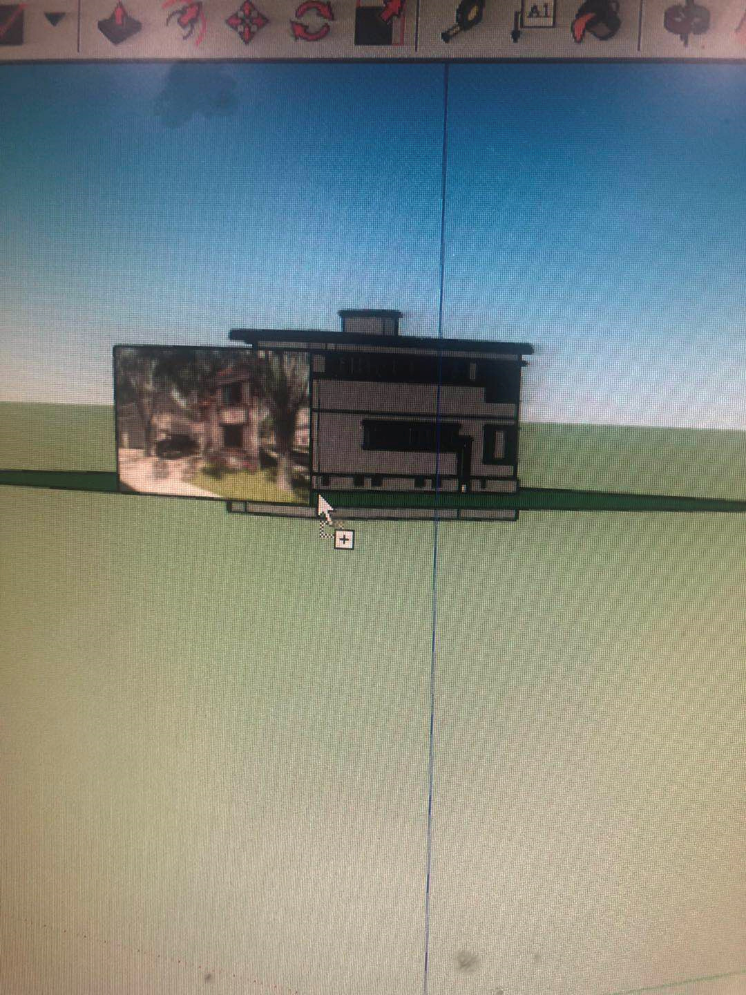

I know how to relealize the effect like linetool ,which shows a dynamic line,
and I wanna know how to dynamically display complex 3D graphics with color ,instead of a dynamic line, like the effect of dragging skp file into Sketchup, the 3D graphics move as the mouse move.

well ,i did not make it clear , i mean that create a tool ,in which the interface Tool::draw(view) can draw a 3D graphic,for example,a cupboard composed of faces and rendered in some color by
the API of class view from Tool::draw(view). I don’t want to load a skp file to get a created model to load.
