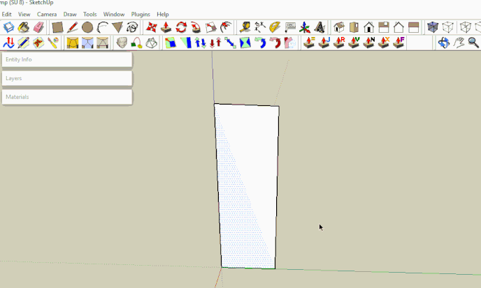

Hi,
I am quite new at SketchUp and learned a lot from the many instruction videos, but I cannot figure this one out:
How can I merge these two faces to one?

show hidden gemoetry and delete the line.
The corners of your shape are not coplanar; they can’t be covered by a single SketchUp face because faces are always planar.
That way you can merge the two faces:
But it’s easier if you draw the rectangle from scratch.

That makes sence Steve, I will look into it.
Thanks Mihai,
That was very clear. I know I wouldne quicker re-drawing the geometry, but this is meant only as an example.
You made it very clear what is going on here. Thanks again.
