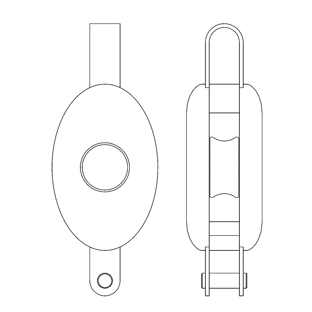

I’m thinking the becket needs to be larger in diamter and the top of the strap should be farther up above the cheeks.

I’m just comparing what I see in your screen shot to the model I created.
Blocks 2D
