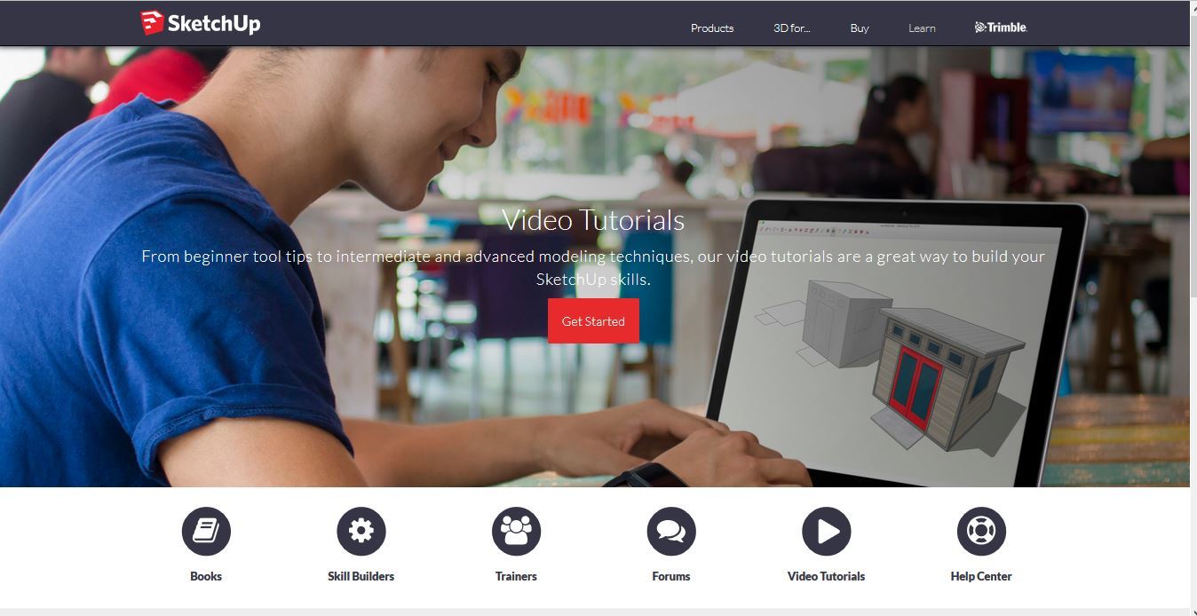

Hello to you, Down the road if you need more instruction this link will lead to the help page:
http://www.sketchup.com/learn
Also if you click the little house icon at the top of the page it will direct you there as well. Clicking on Learn will open this up to you.
The Skill Builders and Video Tutorials are full of all the basics you will need to cut out some of the frustrations that come with getting started. It sounds like you prefer to be hands on and these will help you teach yourself. Or save a bit of time hunting for your solutions The Help Center provides all the documentation for all the programs capabilities. …Peace…
