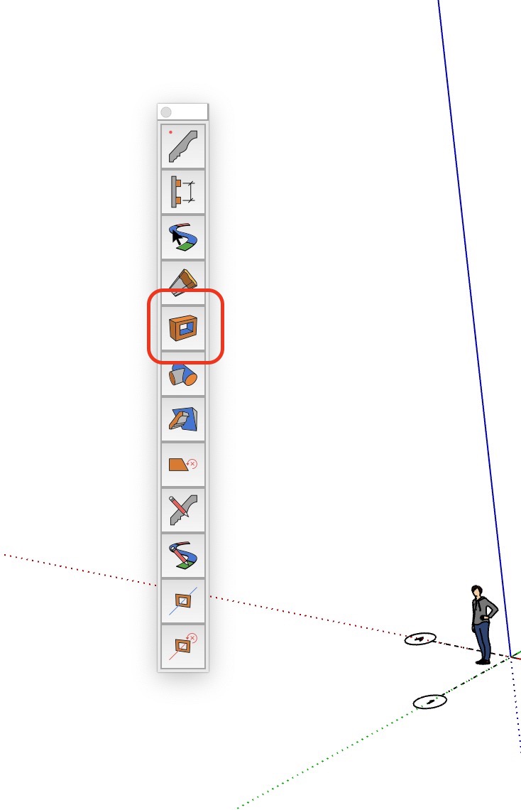

I’m not as familiar with Visuhole or Double Cut as FlexTools, but FlexTools can’t straddle more than one face in order to cut a hole. It can cut through multiple layers, but it won’t cut through a ball, or curved face or corrugated face, etc. Perhaps what you need is to make a cutter object and use solid tools, or better yet, Eneroth’s solid tools. The latter works better with components.
