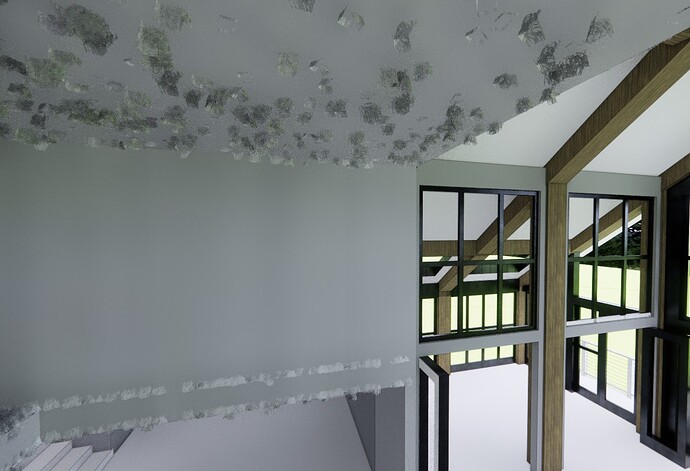

How do I remove this weird texture on my materials?
No matter what material I change this to…this weird texture is still happening.
Do you know how to remove it?!
have you applied a fur to one of the objects?
Upload the model file .skp, not just an image, to enable people to help you better.
I applied grass to a different area and think this may be grass growing on other things now! :upside_down_face:
I modeled in Microstation and exported to Sketchup. I’m using enscape extension. There is grass growing on my ceiling! This place will be condemned
for sure.
