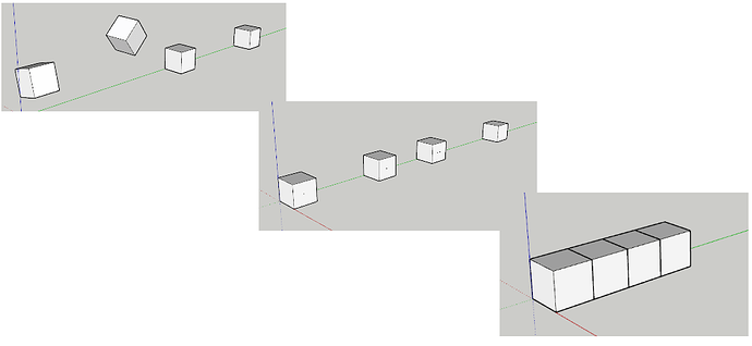

How can I quickly make all these cubes stick together, when they are separate cubes?
I want to make the cube from the 1st photo to last photo, What’s the short key or faster way that can do it?
Now I have to rotate one by one first, then align together, then point to point and stick together.
Any faster way?
Select three, erase, set the one that is left in position and MoveCopy that cube.
Note: if you use components, you can erase them all and drag a new instance from the component tray, then copy.

@MikeWayzovski’s answer is the obvious solution if all cubes are identical. If they weren’t, there is no shortcut way other than what you have described.

Using Curic Reset Rotation and JHS PowerBar plugins
