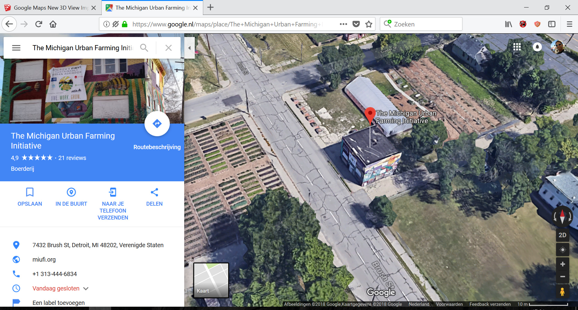

To me it looks the same in google earth and google maps…

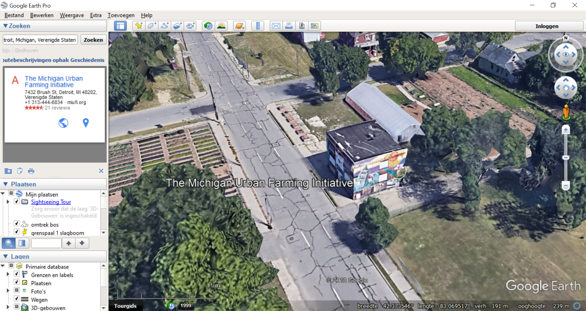

Compare this screenshot that I just took in Google earth with the GIF of Google Maps 3D in the same location in original post. Google Earth’s 3D, by comparison, is basically all flat with the occasional boxy structure sticking out
Actually, I just looked at the same spot in Google Earth browser version and it’s totally different than the desktop app. Maybe I should just abandon using the desktop version

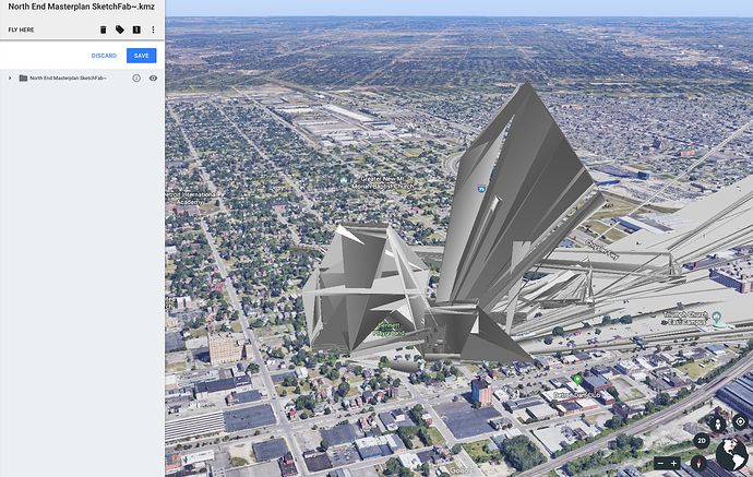

Do you know if it can work the otherway around? Can we upload SketchUp files into GoogleEarth? I know in the Desktop version I could export SketchUp as KMZ and open in Google Earth, but it looks like Google Earth Browser version only works with KML?
I just tried to upload a model (as KMZ since there’s no option to export as KML) into the GoogleEarth browser version and I ended up with this:
When the model look like this:
Same 3D trees and buildings here…
That’s weird. Maybe there’s just something wrong with my version?
Have you checked 3d buildings in google earth?
yeah - you can even see in my screenshot that a really basic version of the multicolored building is shown in 3D - the buildings are definitely working, they’re just not as nice. Maybe I need to uninstall and reinstall the program
In your screenshot only the building that you are working on seems 3D, and the graffity is not there…
Maybe you made the building yourself and imported it in Google Earth?
If so, i think it is stored locally so only you can see it…
