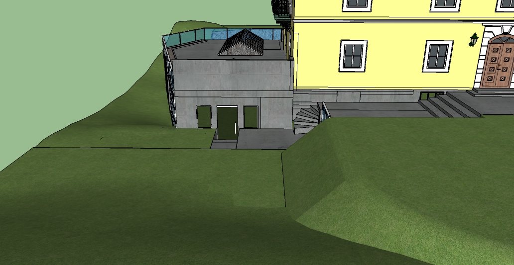

These are the modeling progress so far. But the terrain and landscaping he rejected.
In SketchUp you can position your alleys, stairs and terraces, and in Sculptris you can shape your land around them and import back in SketchUp as OBJ file. Or you could try with Sandbox tools (SketchUp).
The slope at the back looks too steep - I would raise the retaining wall.
Consider pushing the lower retaining walls back make more space / light around the glassed in extension (reorient the steps).

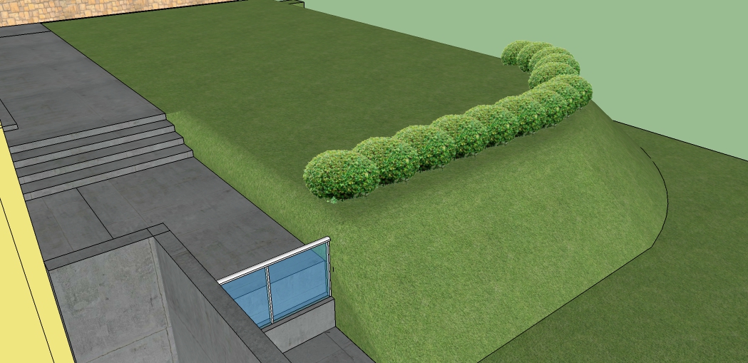

Right now I am working on that part. It an embankment in the right and a walkway/footpath going from west to east. But still it is not refined. It is done by Sandbox tool.

Haven’t tried match photo. But used sandbox to model that walk way. Please check it. and let me know how can I refine it?
