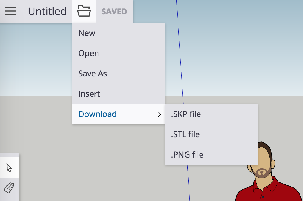

Png support is now added
Downloading works fine. I was trying to EXPORT!
Seriously, thank you. I didn’t make the connection between the change in verbiage.
