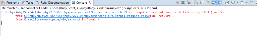

i am new to ruby [programming. Attached herewith the screen shot of error console while loading in eclipse.
Where i am missing out. could u guys help it out

From the error message it’s failing in line #2 when it can’t find ‘sqlite3’ to load it…
I think you should be running your SketchUp based files from within SketchUp [it uses its own Ruby-subset]
You cannot run separate Ruby files and hope they magically connect with SketchUp’s own set - however, you can ‘require’ additional Ruby methods into SketchUp’s own, given the proper path is specified…
Well, the error is pretty easy to understand: Error: #<LoadError: cannot load such file -- sqlite3>
You don’t have the library installed in any of the known install directories.
