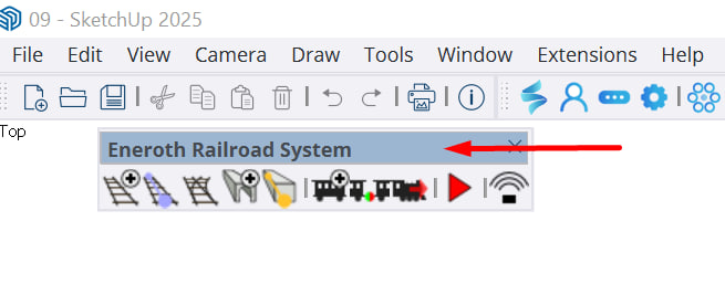

There was a problem when using the Eneroth Railroad System plugin in SketchUp 2025.
The plugin is installed correctly, and the toolbar is displayed

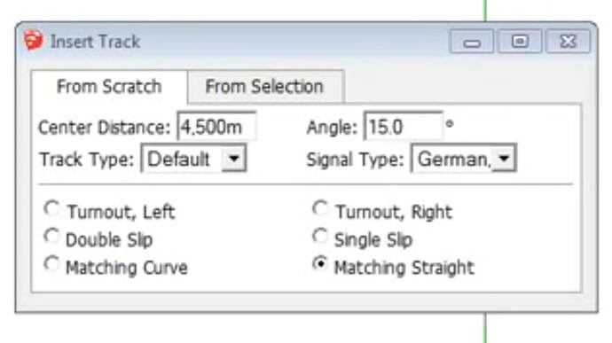

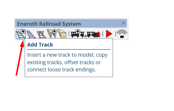

However, when clicking on the “Add Track” button, the “Insert Track” window does not appear for entering parameters.
Can anyone suggest how to adapt/update this plugin for SU 2025? Perhaps an update to the dialog box invocation (HtmlDialog/WebDialog) or compatibility with Ruby 3.2 is required?

I think there’s been a decade or so since I published the latest version of this extension. It’s heavily outdated and has a lot of issues. I’ve been wanting to fix it, and even spent a few weeks on it last year, but it’s such a large project I haven’t gotten to the point I can publish it.
If it does not work in 2025, my recommendation would be to try an older SU version.
