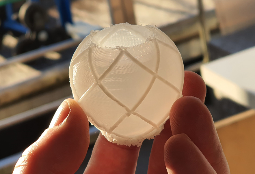

One tip, have you tried not making it shiny, just print it as it is without trying to do outershell. Most printers will happily print the multiple solid components and the fact they intersect is incidental.
Yes I did try printing a multiple solid version. My slicer / printer combo (cura,ender3pro) put voids into the path intersections. It’s like the two paths cancel each-other and there is nothing printed in the intersection space, so the print falls apart. Could be a slicer setting, I’ll look into it, it would certainly be much easier.
Look for an Unsolid model option in the print settings.
This is normal print, you can see the voids at the joints.
And this is with Unsolid ticked.

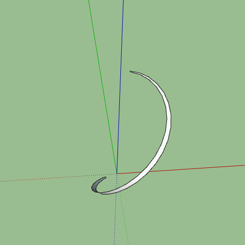

This is my first thought on the subject, I have cut the ends off just because they come to a point at the poles which causes the shape to not be a solid.
I have used extensions.

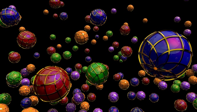

Nothing on TV tonight so had to fiddle the decorations. Started in 2020. Then decided I needed 2019 for the render, save as back to 19, fiddle all the bits…looks good
hmmm one single bauble… it’s a bit …simple… can I add more
Add a few, an array? Nope, needs physics! Some random clashing. Save as again to 2018…

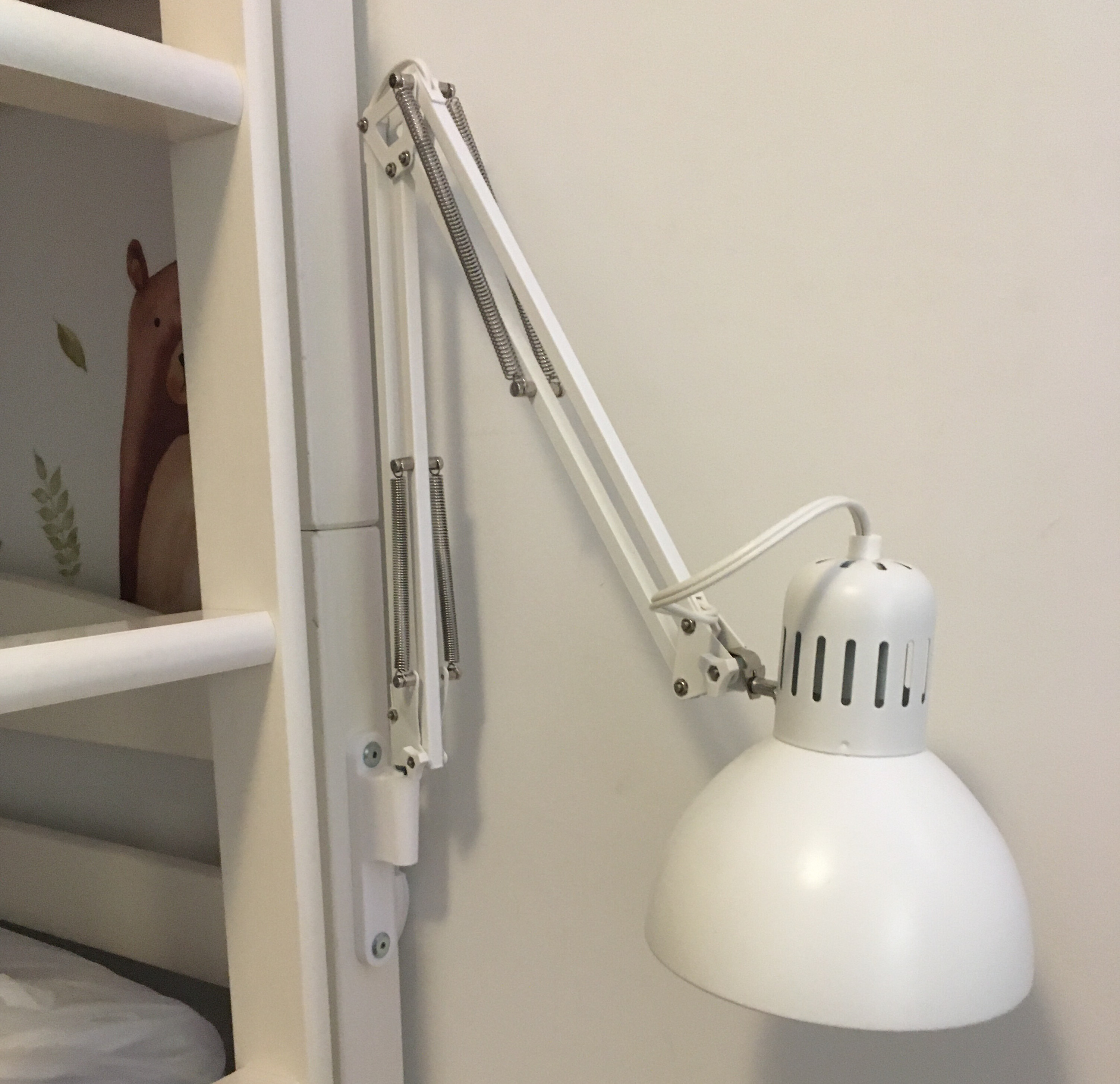

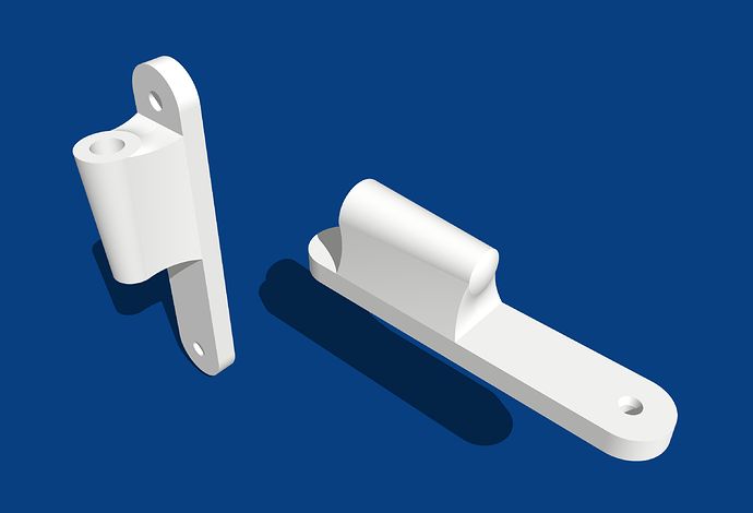

Sometimes I find simple practical solutions to be some of the most rewarding, even when the modeling is not so demanding. A new reading lamp pedestal socket designed to attach using the existing bunk bed hardware. Bolt spacing turned out to be a very odd 132.5mm on center, only Ikea knows why.

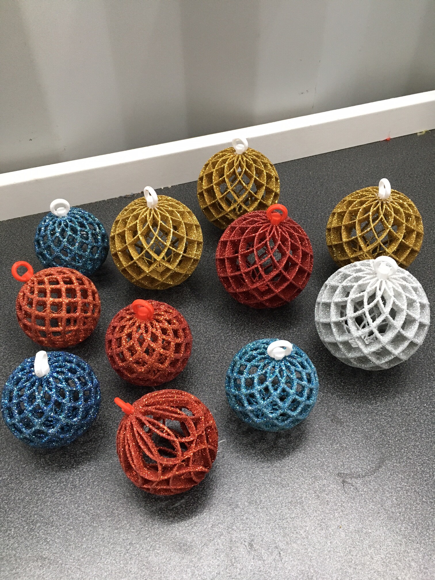

I really caught the bauble obsession this year. Designing and printing them has made for a lot of fun and learning with just a dash of hair tearing frustration. Mostly it’s given me something to do in the in-between moments to keep me moving and out of trouble, a big thanks to all who contributed thoughts and ideas. Once I got started I could not stop, I ended up making something like 40 of them, and eventually got into glitter coating them in custom mixed colors. I think I’ve got all that out my system for now, but the results are sparkling on our home tree spreading glittery 3D SketchUp joy.
I wanted to share some of that joy with all of you, my extended SketchUp family. I wish you all a very Happy Holidays.
