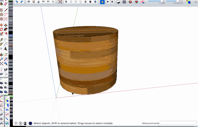

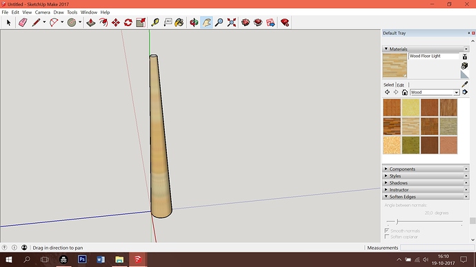

I’m learning to work with SketchUp Make 2017.
There’s only one problem; I can’t seem to open the ‘Context Click’-menu on 3d objects. I want to change the position of material (turn it 45* to the right) on a cone. I can only open the Conext Click-menu on a flat surface.
I know I’m doing someting wrong but I can’t seem to find the problem. On YouTube I couldn’t find any tutorials about this specific subject.
Down below you see the cone (i’m making four of them because the cone is the ‘leg’ of the table).
The cone’s material is wood. It’s now horizontal but I want it to be vertical.

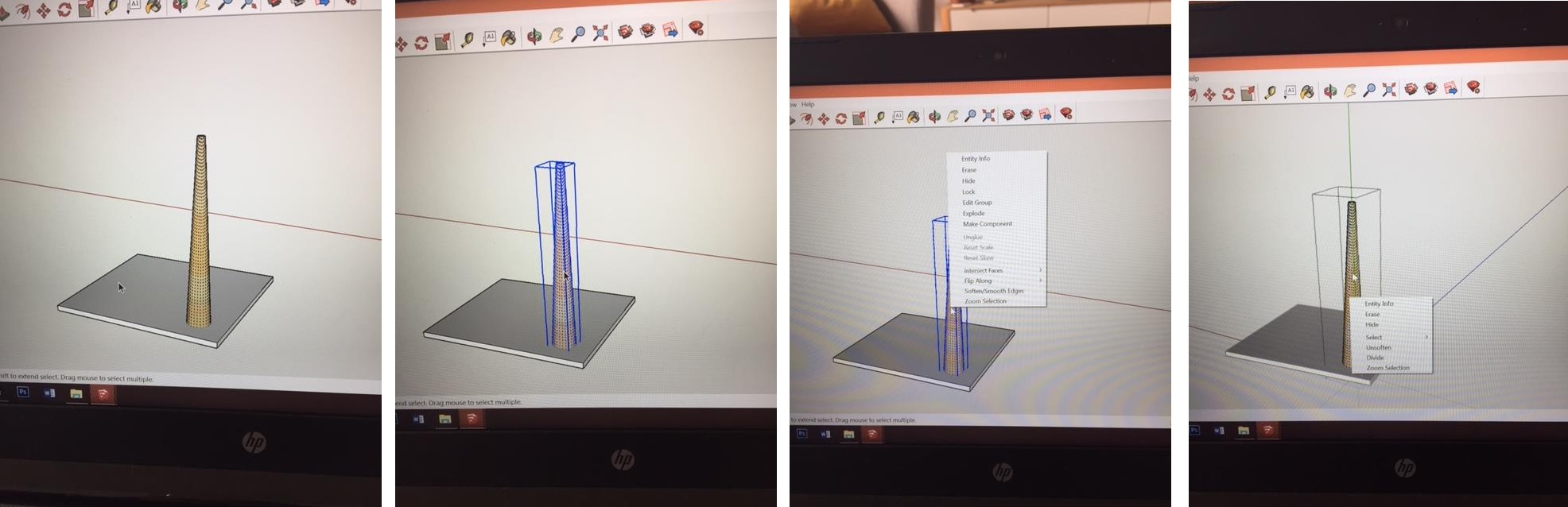

Go to View and tick hidden geometry, then go to your leg and select just one face bordered by the hidden geometry. Now right click/ texture…

I’m still clearly doing something wrong.
I get the steps: Go to view, tick hidden geometry.
But the next steps I don’t understand. I think because of the language barrier. Can you explain what the next steps mean? Maby than I can translate it to my own language and know what I need to do.
I made a screenshot for you. I also placed the leg in a group. Thats because i’m a real photoshoplover and wanted to put everything in its own layer so I can adjust everything on it’s own. Couldn’t find the ‘layer’ option so I thought iIm making a group. No idea if thats the right thing to do…

I didn’t zoom in enough, that was the problem. So when I zoomed in all the way I could select one of the areas, clicked right and the menu appeard, yay! I noticed that because of the little tutorial you made.
