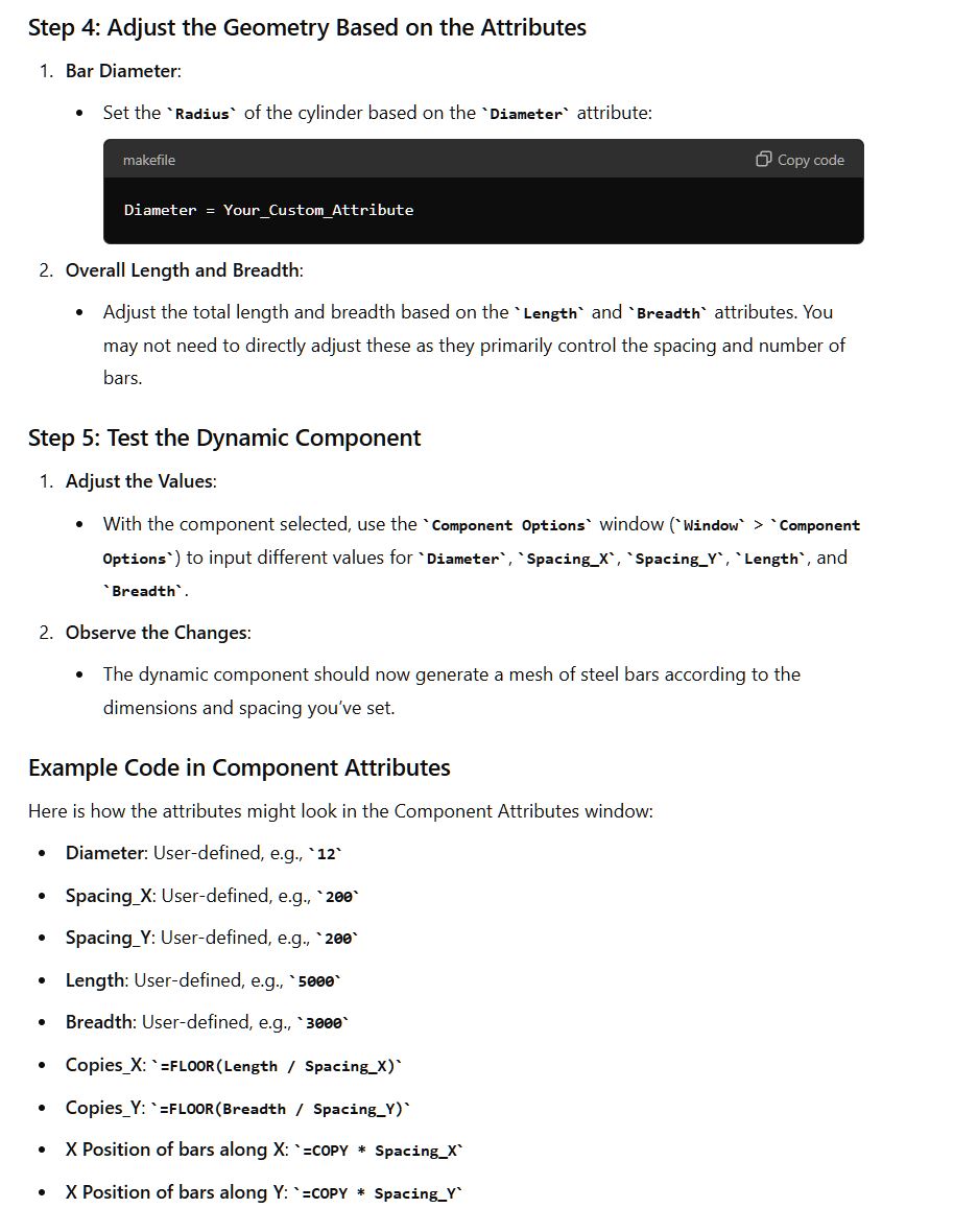

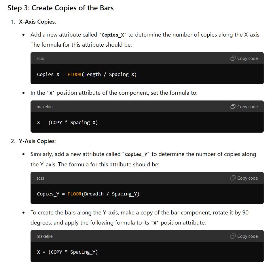

Well , another little surprise today, thought I would ask if ChatGPT knew anything about dynamic components in Sketchup… Here is the conversation !
I really think we need a separate discussion group for AI. :slight_smile:
Yes, the AI did not present a workable DC… but it made a good attempt…
I did tell it one error and this was its response
I won’t take this further on the post, but it certainly is worth our attention!
