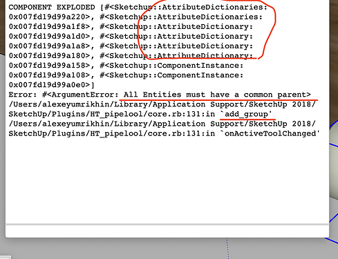

Hello. I’am trying to make my projects a little bit lighter by replacing dynamic components by usual ones.
I want to explode a dynamic component then make a group from it and then make a usual component again.
                selection = $SpawnedComponent.explode
                puts "COMPONENT EXPLODED #{selection}"
                Sketchup.active_model.definitions.purge_unused
                Sketchup.active_model.active_entities.add_group(selection)
My way doesn’t work because some dynamic component information stays. Please be adviced how could I avoid it.

Tried different variations but doesn’t work… Probably I’am doing something wrong but tried both in console and in script… Result still the same :roll_eyes:
Yes you are. The Sketchup::Selection object does not have an attribute_dictionaries method.
Only subclasses of Sketchup::Entity have this method. So you’ll need to get an entity object FROM the selection and verify that it responds_to?(:attribute_dictionaries).
