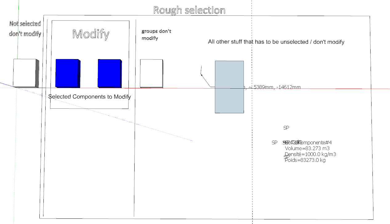

Sorry, I should have explained my developement intension more precise: My aim is to select an area of my model that contains a bunch of entities in extremely case all possible entities: components, of course, and the other stuff, groups, labels, lines, faces etc. BUT in doing so only the components (AND only the selected ones) should get modified / get attribute properties.
While formulating my anser I thougt about perhaps another approach.
First make the (rougth selection) perhaps selection of the area of an upper floor of a woodframing house (posts,studs, girder, plates)
Unselect all entitys that are NOT a Component (==> all other in 1. sleceted things)
Assignt only to the selected components dynamic_attributes like name, coulour, material, etc…
How do I automatically unselect all other stuff (entities) exept the components within my afore done selection? / how to express in ruby?
I though you only had selected the objects of interests and I couldn’t figure out why your snippet didn’t work as you expected. The image made it clearer what you intended.
