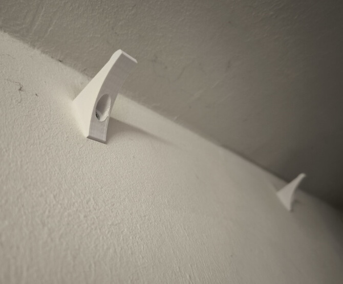

We looked for a suitable place for a tray and found one in the storeroom with the help of two printed holders…
SketchUp:
Slicer:
Installed:
Large facets (few triangles) compared to more triangles or a sphere, the airflow is disrupted at the edges of the segments, likely possible causing turbulence.
It gives higher aerodynamic drag compared to a smooth sphere and an increased drag coefficient.
Also an increased vortex formation behind the object, especially at higher wind speeds which creates a vacuum and disform the ‘sphere’ back side
Localized pressure peaks on the facets oriented perpendicular to the wind direction and also disform the ‘sphere’ front side of the wind direction. So the top wil be a pivot point and may get twisted a little, maybe enough of to crack the plastic.

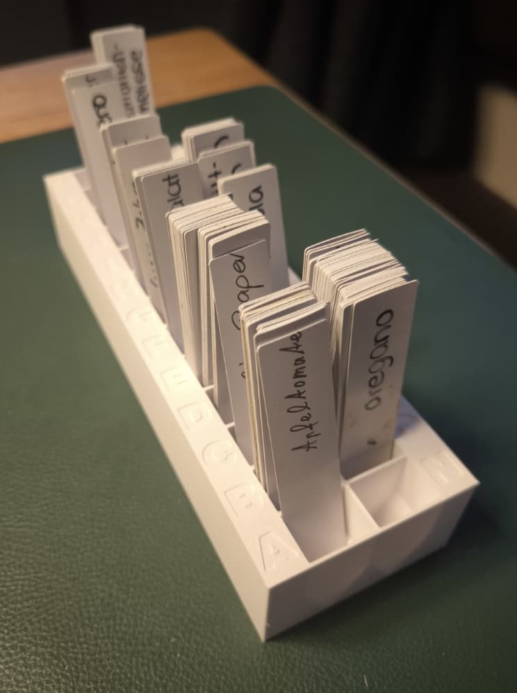

The plant labelling should be used again, but if they are all mixed up in a box, you can’t find the one you want. Now they are sorted alphabetically…
SketchUp:
Slicer:
Printed and in use:
Good idea. I always end up losing them or keep them all into one big, messy shoebox.

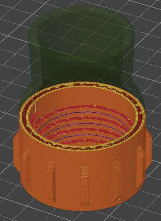

New woodworking tool and, unsurprisingly, yet another adapter for the extraction system.
SketchUp:
Slicer:
While printing:
