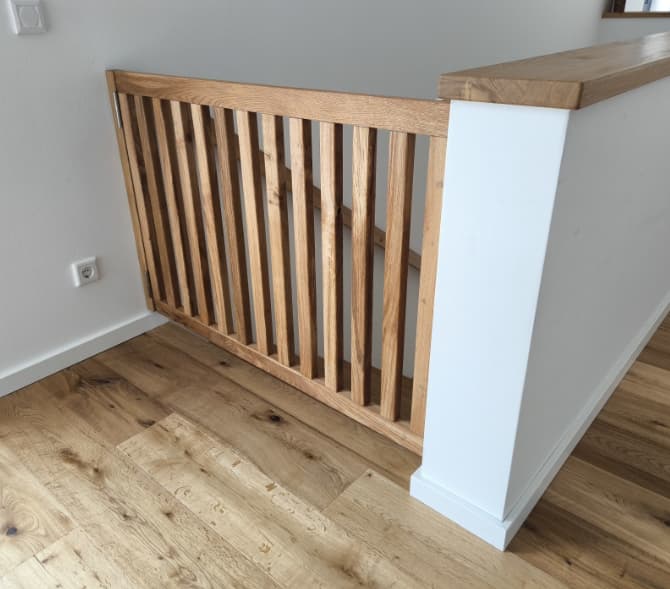

The gate for the stairs, designed to protect my niece’s toddlers from falling down the stairs, is now complete. The installation space for the lock was smaller than anticipated, so I developed version 2 with less installation space…
We will see how much opening the construction can handle, which, as with most 3D-printed parts, is probably significantly more than initially assumed.
