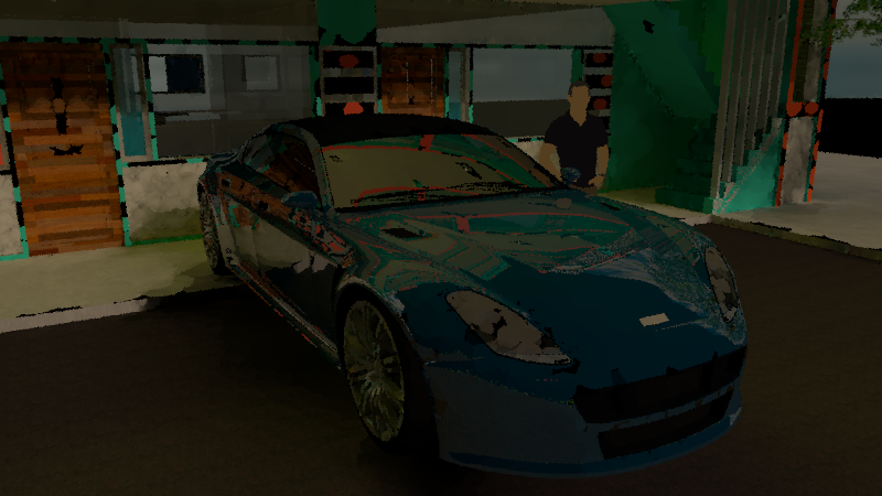

hi guys, i need some help of experts here, i cant find the right setting for this or shall i change my Laptop. i think its not compatible such work of rendering…
If the rendering application works on your computer, its specs only affect rendering time. The final quality is dependent on your modelling, materials, lighting, etc…
