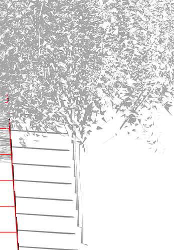

Hi, I’ve been able to change to component I need to red outlines, but at the same time in this mode, all the rest of the model has now got various multicolour outlines too now… also in wireframe mode my trees look not very good - they are invisible.
Does one need to stay in wireframe mode to see the red outlines (I’m sure this is a silly question), and if so, any recommendations on slightly more legible trees…

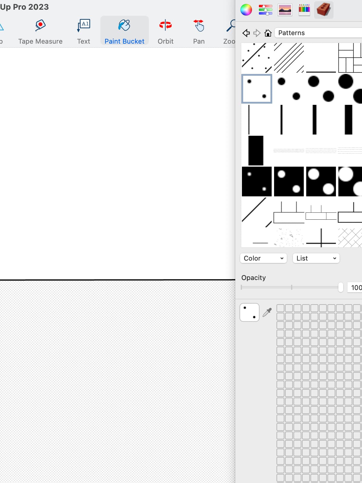

Hi again, I should actually have posted my two questions on one as I’m am guessing it is not possible to show hatches (simple black dots or lined hatch) and ref outlines for one component.
Also I am having difficulty editing the scale of the hatch and there appears to be no size editing mechanism that comes up on my current interface.
Any advice would be appreciated
