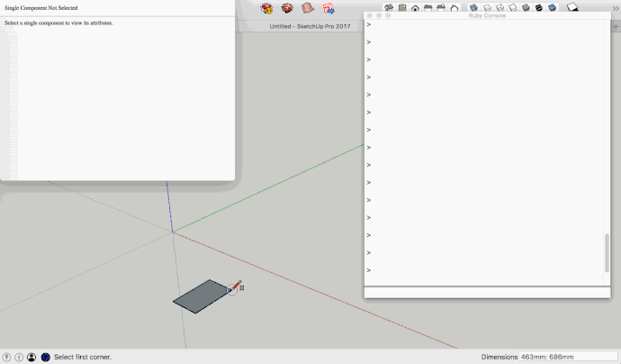

when i set copy attribute, but i can’t see the “Copies” attribute
You are missing some/adding the wrong…:
check with attribute inspector what attributes are being used when adding an attribute in DC.
i set the copy attribute as the “inspector attributes” tools but the "Copies " still not appear.
