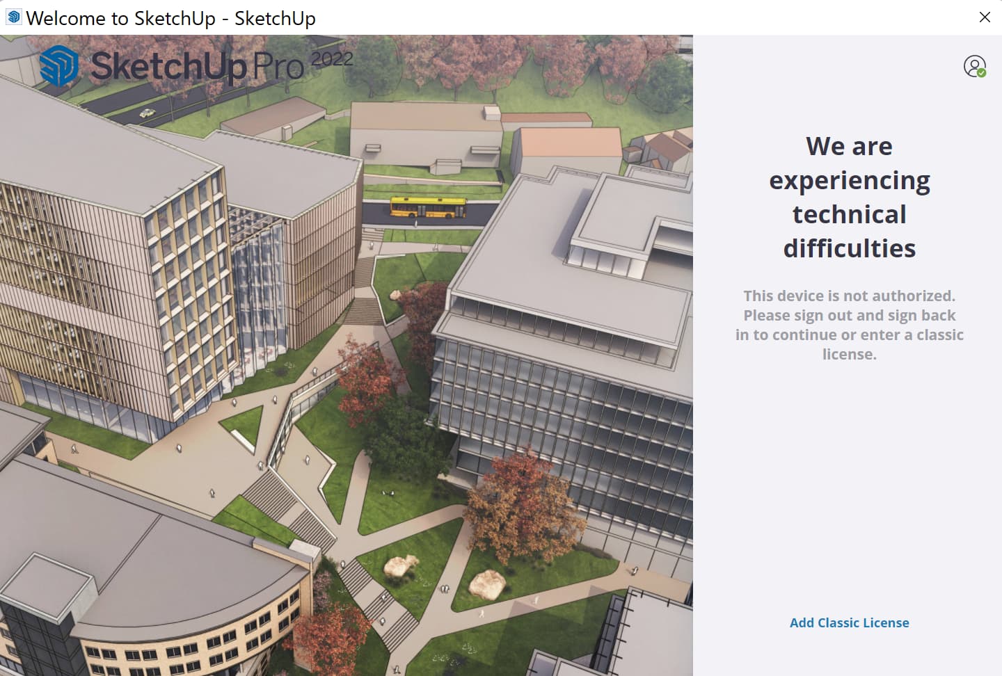

Can't open anything in SU22
I can open SU21, but not SU22. I get this message:
Did you install SketchUp 2022 correctly by right clicking on the downloaded installer and choosing Run as administrator.
Did you try signing out of SketchUp 2021 and then signing in to SketchUp 2022 with your e-mail address and password?
Everything has been working perfectly since I installed SU22. I have been running both 21 and 22 at different times. I periodically shut the computer down, and re-boot, which is what I did today. Now I have this problem.
Try repairing the installation of SU2022 to make sure it is installed correctly. Remember to right click on the installer and choose Run as administrator. Actually an update was released yesterday. You might as well download that and install it.
Reinstalled (as administrator) and get the same results. Tried opening both an existing model, and from the App menu.
It just started working. I got the same message initially, then a few moments later, the model was up on the screen. One of the reasons I rebooted the computer was because, when I could not draw a line in the model. I still have the same problem.
