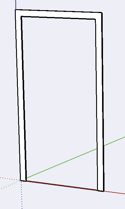

With those fixes, your code loaded and ran fine. It drew this:
