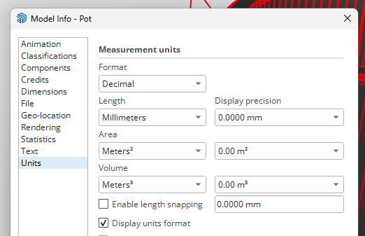

Yes you have. You have Volume units set to Meters with rather coarse Display Precision. The size of the object is too small foor the settings you’ve chosen.
Set the volume to cubic millimeters and you’ll get a volume that makes sense.

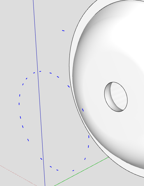

BTW, you have some stray edges that you should remove.
Amazing! Thank you!
I didn’t even know that those settings existed. Thanks for helping with this and helping me learn.
