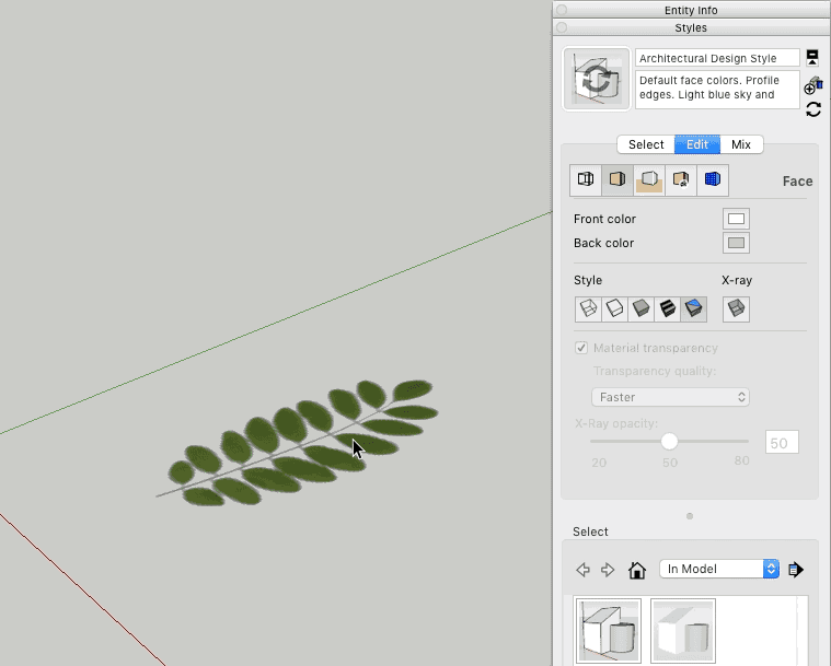

Thanks Forester but monochrome didn’t help and I had to find a workaround to solve the problem.
I drew two equal rectangles and import on each my leaf as texture and reversed one, that made it and grouping each separately I was then able to fold my leaf, Yeah!
Resizing was also necessary and here is the result now:
Perhaps you misunderstood me. I didn’t say to use monochrome.
When you import a png and it turns white after exploding, that’s what happens when the face style is set to monochrome. So I suggested you set it to “shaded with textures.”
I’m glad you figured out a workaround though! Also, I checked out you behance and you’re really talented. Your architectural models and art are amazing!
