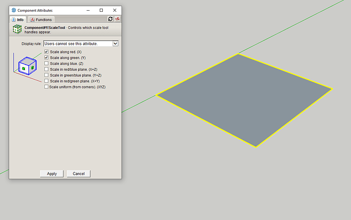

Hello!
With SketchUp 2026 I can’t limit Scale Handles to XY axis anymore. They just disappear.
Problem shows up on both SketchUp for Desktop and Web.
Works OK with 3d objects but breaks for 2d ones.
A new bug for sure! @colin
For now, can…
I logged a bug report about this. SKOR-20946.

I checked previous version and just deselecting the xyz, produces same behavior as my previous post for 2D DCs, so a bit of time in fixing your collection should not be wasted. As waiting for a bug fix may be more time than you have.
