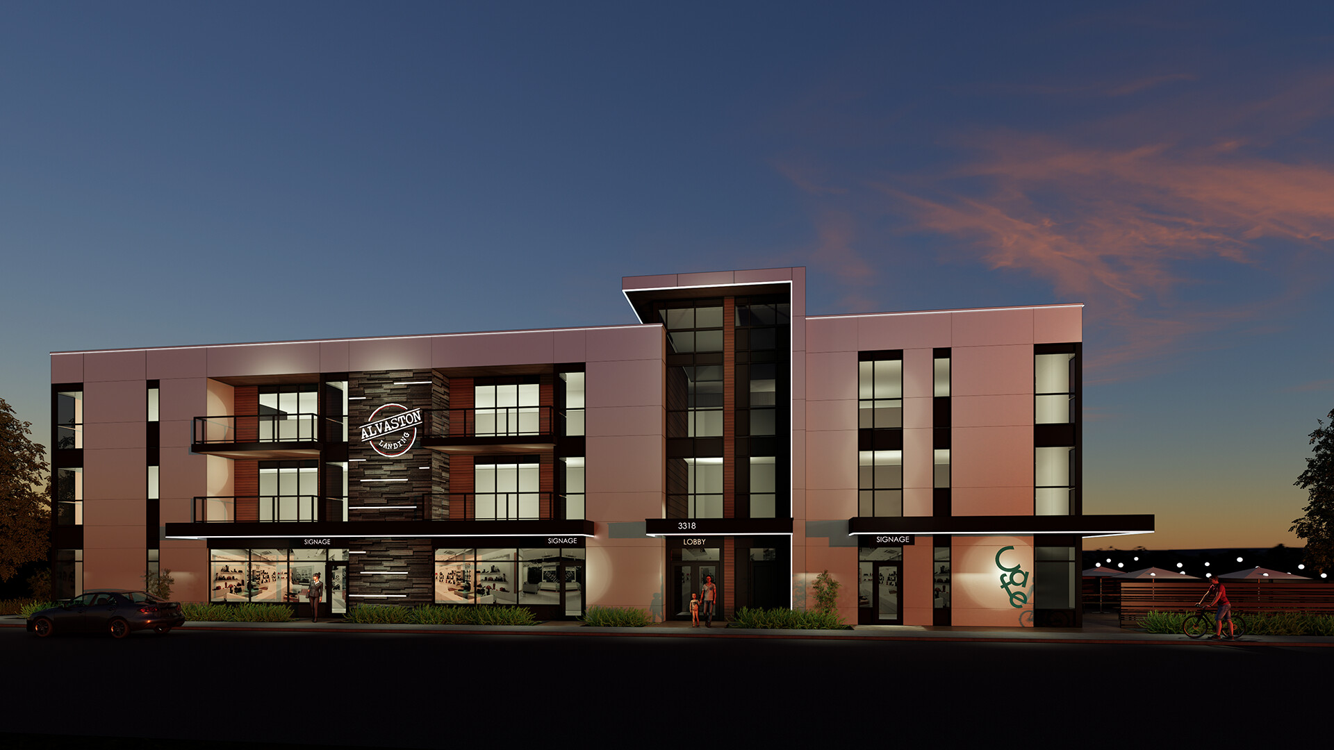

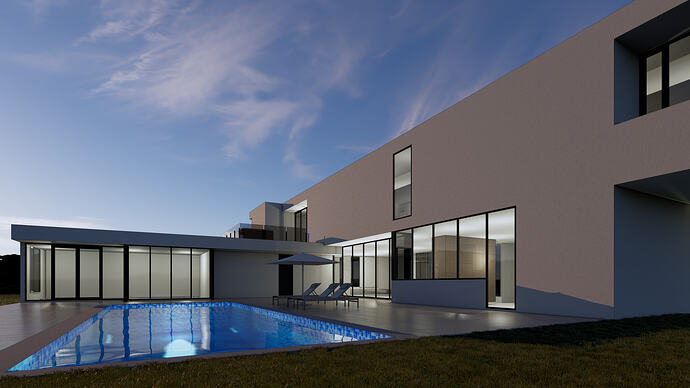

I’m using Brighter3D—you can generate images like this (from the main page) in seconds, without an expensive GPU.
Check out my other renderings in the thread:
$149 one-time fee for a lifetime license, or $75 if you don’t plan to upgrade your SketchUp version soon (compatible with SU2017–SU2026).
