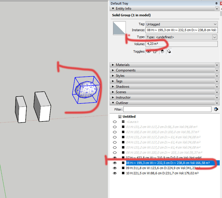

Well done, you are wonderful, thank you very much, regards, and love, can I add the volume values, or just the volume? Thank you very much Sir.
Thank you very much, dezmo, I found something like this, I would appreciate it if you could evaluate the code, you can exist.

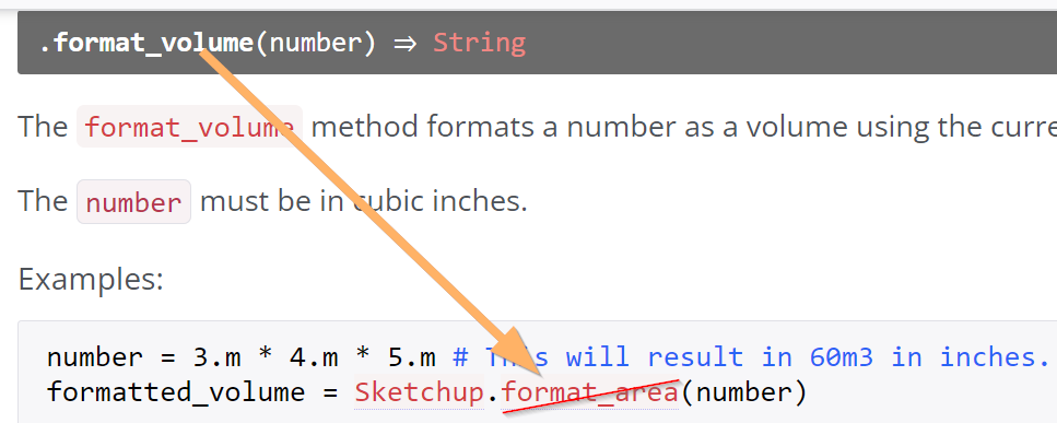

You can extend my code e.g. by adding the method after “extend self” line:
  def g_volume(group)
    v = group.volume
    v > 0.0 ? " Vol:#{Sketchup.format_volume(v)}" : " Vol: Not solid"
  end
and change the e.name = add_zeros(@num.to_s) + h_w_d(e) line to
  e.name = add_zeros(@num.to_s) + h_w_d(e) + g_volume(e)
@dezmo thank you, I tried, but the result is the knowledge of the field, I guess…
Oops, obviously I’ve copy-pasted the mistake from the doc of
format_volume method…
Edited my previous post.
I can’t even see a mistake in this little one, but I will learn with you, my teacher, I looked up yes, I say how did I do it :slight_smile: teşekkür ederim .
