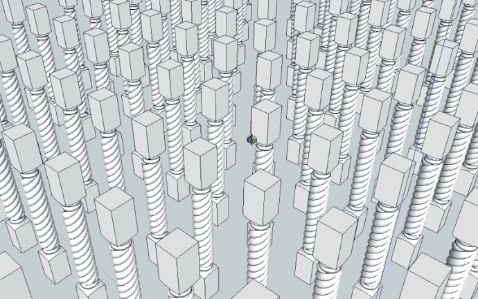

Are you referring to this component? It does have some issues.
It’s generally considered good practice to open components in a separate SketchUp file, inspect, and repair them as needed before inserting them into your main model. This helps to prevent issues such as you describe.
I would draw something like that myself rather than depending on someone else and I’d make sure the component is considered a solid by SketchUp before using it in a model.

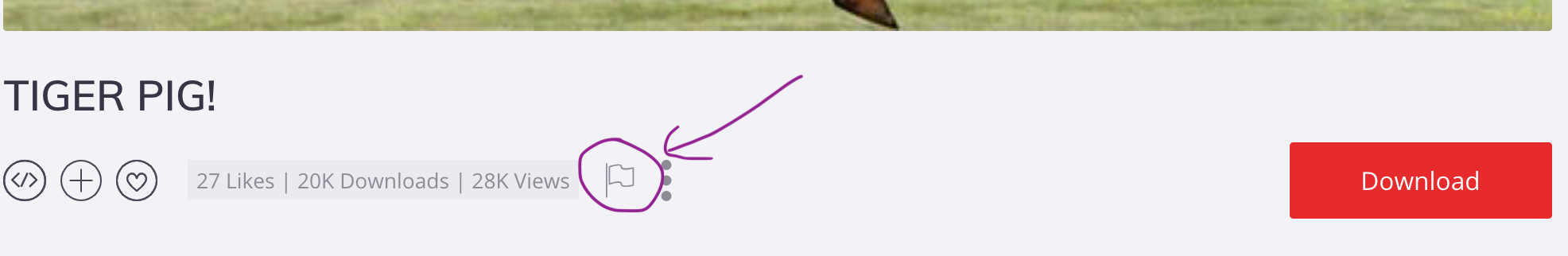

To flag a model on the warehouse, click the ‘flag’ icon under the model title on the model page.

Barry, the leg the OP was referring to is this one:

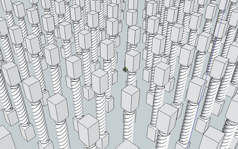

Here’s a pretty one, until you turn on hidden geometry.
And another thing of beauty by the same author
