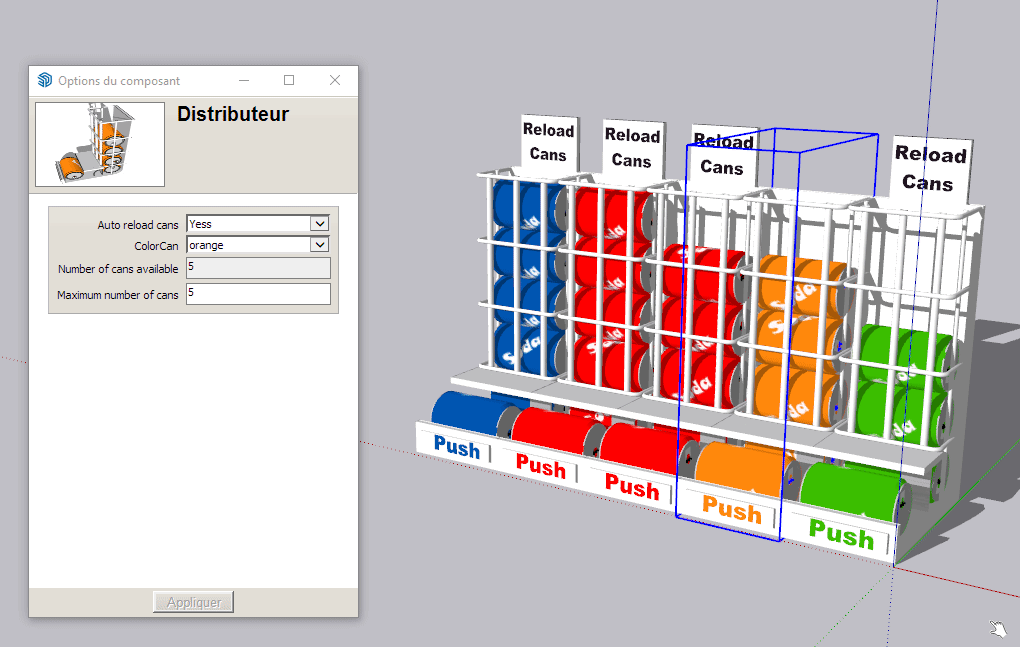

Hello
Do you want something like that ?

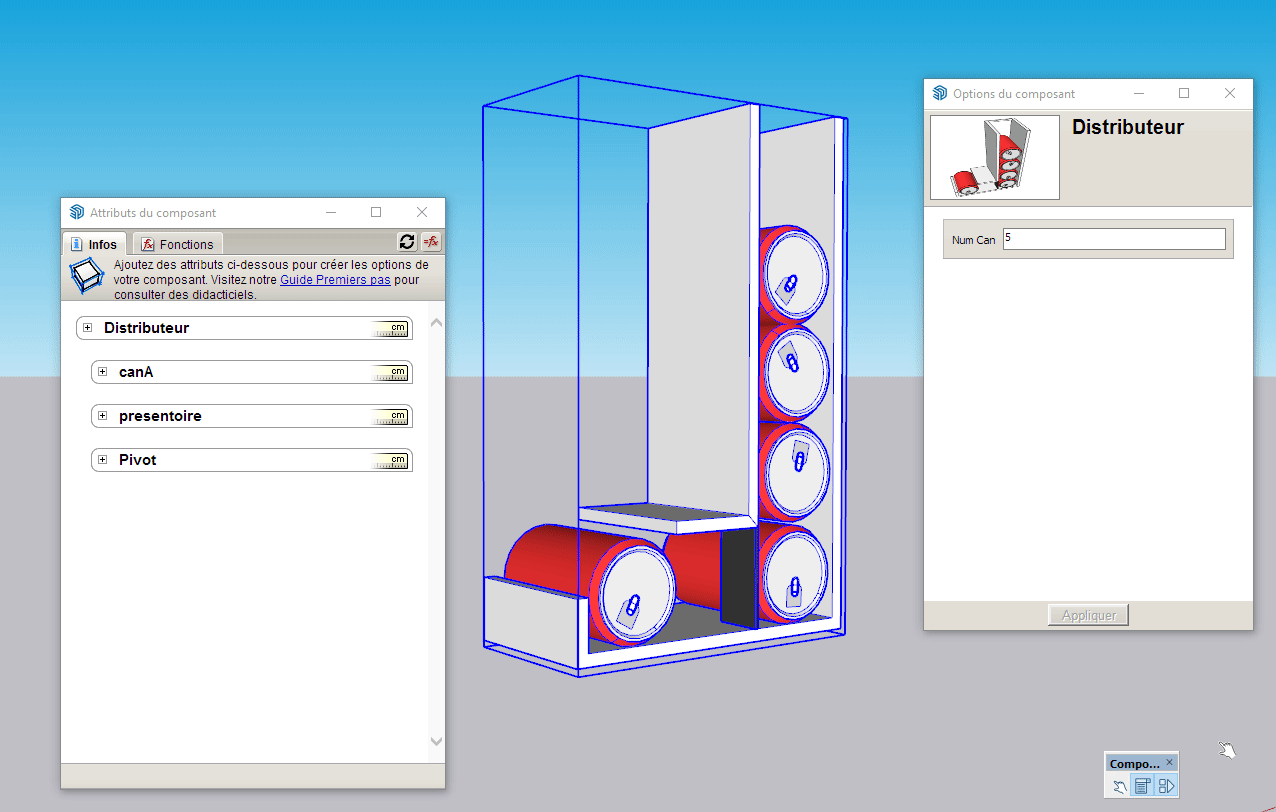

Hello
Version with better rendering and only one subcomponent with copy. Bobbin rotation, pivoting retaining flap
THATS IT! Thank you so much im going to try it and let you know!
Attribute of the number of cans,
Challenge with option auto reload or not !
:wink:
