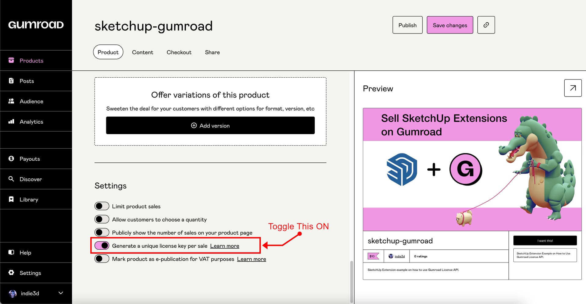

Hi, I recommend looking into Gumroad.
Here is an url that talks about license key: License keys - Gumroad Help Center
Check the code in this ZIP file and if you have any questions let me know.
gumroad_example.zip (253.4 KB)
Note: In order for the code to work some of it need to change… For example;
In the modules folder their is a file named ‘callbacks’…
Change [YOUR GUMROAD NAME HERE] and [YOUR PRODUCT NAME HERE]
UI.openURL("https://[YOUR GUMROAD NAME HERE].gumroad.com/l/[YOUR PRODUCT NAME HERE]")
Also, in the load.rb some strings need to be changed…
Change [CHANGE TO A FOLDER NAME] to a folder name your happy with.
PATH = ENV['HOME'] + "/Library/Application Support/[CHANGE TO A FOLDER NAME]/#{FOLDER_NAME}/" if MAC
PATH = ENV['APPDATA'] + "/[CHANGE TO A FOLDER NAME]/#{FOLDER_NAME}/".gsub(/\//, '\\') if WIN
And, I expect more things need to be modified but let me know if this is the path you’re looking for.
Here some visuals that might better explain how to use Gumroad License on your SketchUp Extension:
