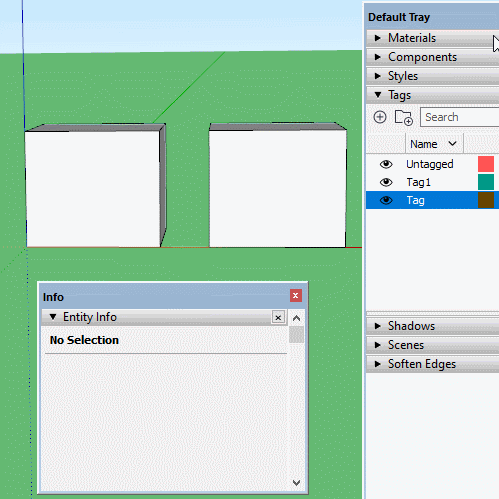

Here is a simple example of why you should never tag raw geometry.
Untagged
It’s still considered to be a bad habit. Tags do not separate edges (geometry in general) from intersection with other geometry that have different tags assigned to them.
The geometry needs to be in a different environment (group or component) to be shielded off.
Also, as @Box demonstrated above, you don’t have proper controle over visibility with raw geometry on different tags. Oly groups and components should have different tags assigned to them. A few exceptions are dimensions, text and guides.
