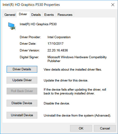

I have noticed this behaviour on every system I have used Layout on so I’m not sure that its the graphics card or driver (as every system has had different cards / drivers and all were kept up to date). I’ve put my graphics card and driver details below (for the system Im on now) just in case, but this has been an issue for as long as i can remember. FYI, I have checked to see if there is a more up to date driver for the Nvidia card but apparently its the most up to date version (see screen grabs below).

I don’t know the exact cause in your case but I mentioned the video card/driver thing because I have seen similar behavior reported for SketchUp in the past and in every case the culprit turned out to be the graphics card.
Despite Microsoft saying the best drivers for the Quadro are already installed, you might try updating them anyway. Go directly to the Nvidia site for that.

There was a newer driver which I have now installed but the issue persists…
