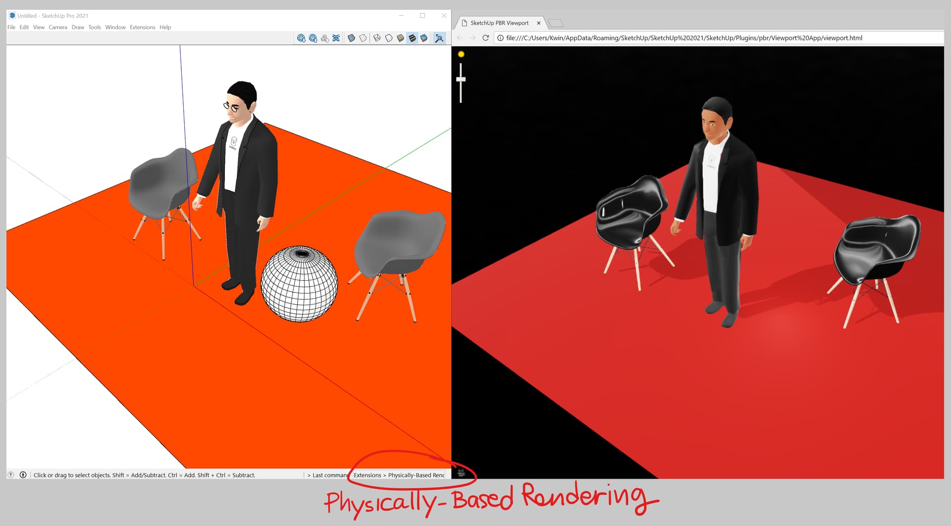

@SamuelTS - Material Browser is very useful extension. Actually ability to search for material used in model should come with standard SketchUp. Hope SKP team will consider improve “Material Window” in future. I also test your another extension “Physically-Based Rendering”, It is good as well for quick getting render image. Just simple and straight forward to use.
