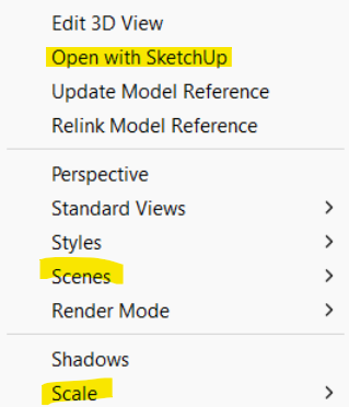

I think I would highlight some of the often overlooked things on the viewport right-click menu. Specifically “Open with SketchUp”, Scenes, and Scale.
“Open with SketchUp” allows you to create the SU live-link. So you don’t have to manually update LO every time you save your SU file.
And you can quickly set scene and scale - it is a lot faster than using the SketchUp Model tray drop-down menus. Since you have to click on the viewport to set scene/scale anyway, might as well be a right-click.
