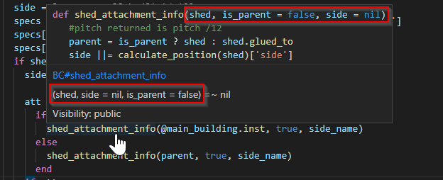

I just noticed that documentation popup in vscode shows the arguments in the wrong order.
This just threw me for a loop.
Is there anyway to fix this? @thomthom

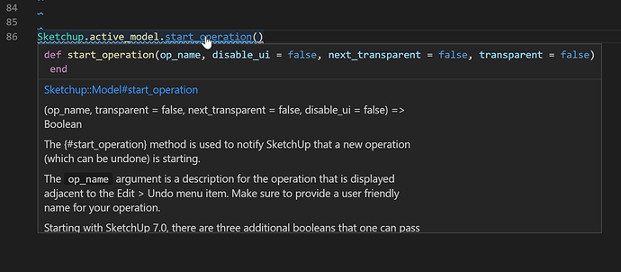

The stubs aren’t the problem. Actually I noticed it in one of my own methods first.

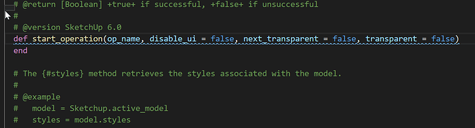

In fact pressing Ctrl while hovering shows the def preview with the parameters in correct order.
Also Ctrl+Clicking the method shows the stub is correct.

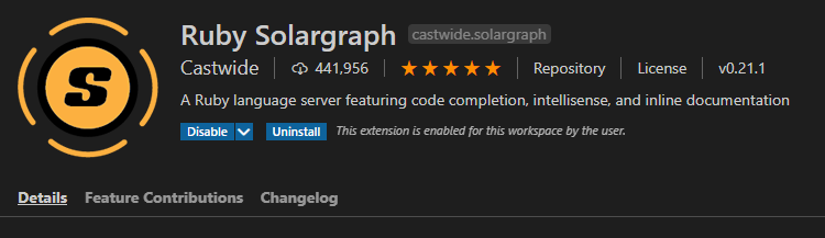

What version of the Solargraph VSCode extension and gem do you have?
Also, I’m currently trying to figure out why YRI doesn’t always generate the YRI database for the stubs. I think it might relate to using Bundler instead of gem install. Look into why stubs are not always available to Solargraph · Issue #76 · SketchUp/ruby-api-stubs (github.com)
Could be worth to try to run yard gems sketchup-api-stubs to explicitly re-generate the YRI database.
I’m using v0.21.1 according to VS Code
