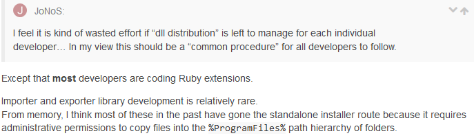

I feel it is kind of wasted effort if “dll distribution” is left to manage for each individual
developer… In my view this should be a “common procedure” for all developers to follow.

Except that most developers are coding Ruby extensions.
Importer and exporter library development is relatively rare.
From memory, I think most of these in the past have gone the standalone installer route because it requires administrative permissions to copy files into the %ProgramFiles% path hierarchy of folders.
