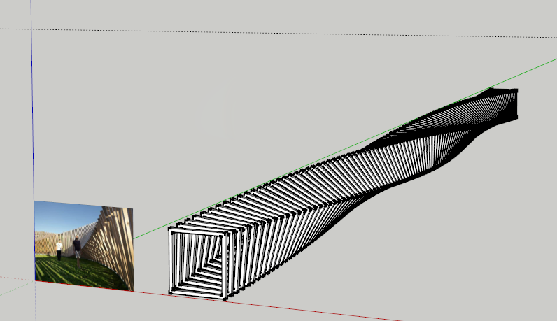

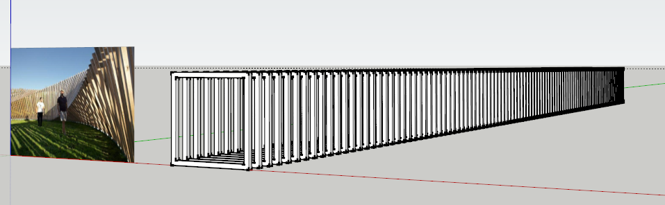

  1. Create a square
  2. Offset a rectangle and delete the excess and pull out thickness
    3
  3. Array function
  4. Select all to create a group. Use Distortion Scaling in FredoScale, press TAB to open the settings panel to set the number of slices, 24 is recommended.Twist an object 180°
    FredoScale
    FredoScale | SketchUcation
  5. Draw two straight lines at both ends of the object and use Radial Bend in the FredoScale plug-in to bend the object.
    Done
