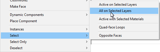

Try Selection Toys from Extension Warehouse!
sel1
This adds the Select/All on Selected Layers command to the context menu.
sel2
