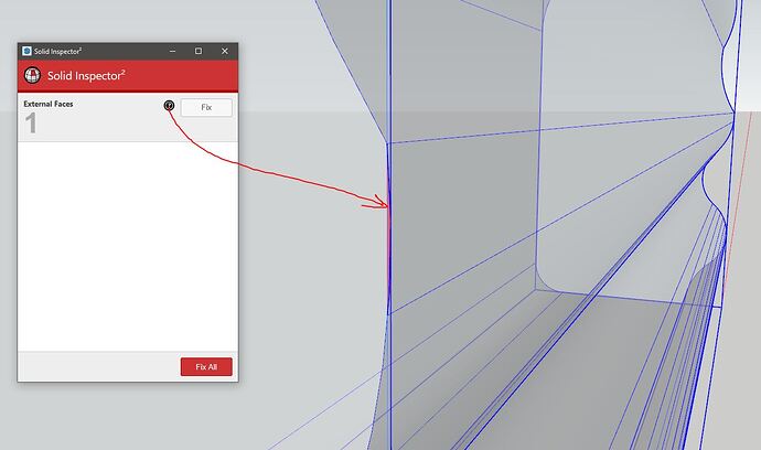

I use Slicer5. But I got massage “Select object is not manifold solid”, I tried to find the lost face or something wrong but I found nothing,
You could try Solid Inspector² to find out why your model isn’t solid.
It’s a very useful extension.
masa.skp (207.6 KB)
how can ı do?
Delete that Arc (3 segments)
si2

masa_solid.skp (248.2 KB)
It’s well worth learning the basics.
A simple delete and you have a solid.
GIF 9-10-2024 8-28-59 PM
