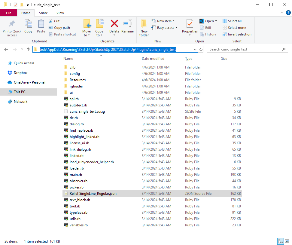

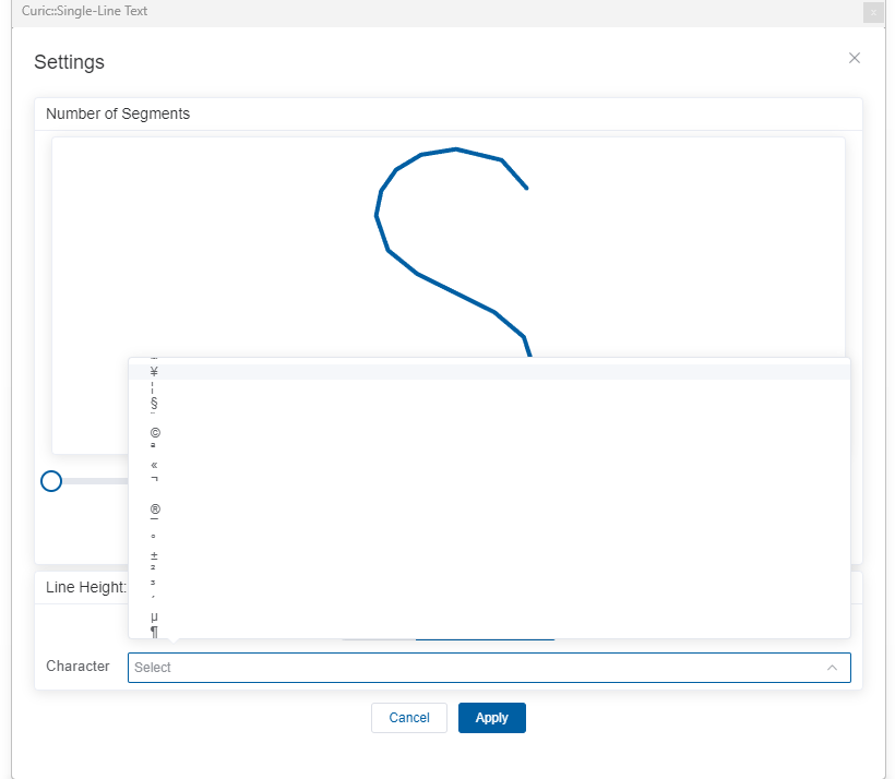

Hi, this plugin @curic4su drawn by himself every letter of the font. So, if you want to use your font, you should do the same, but if it works or not, I’m not sure.
I didn’t know I could add my modified letters to the Curic Line :slight_smile: Is there any tutorial, does it require some coding knowledge? Because in the Curic Line settings (see the screenshot) I don’t think it is possible to model your own symbols

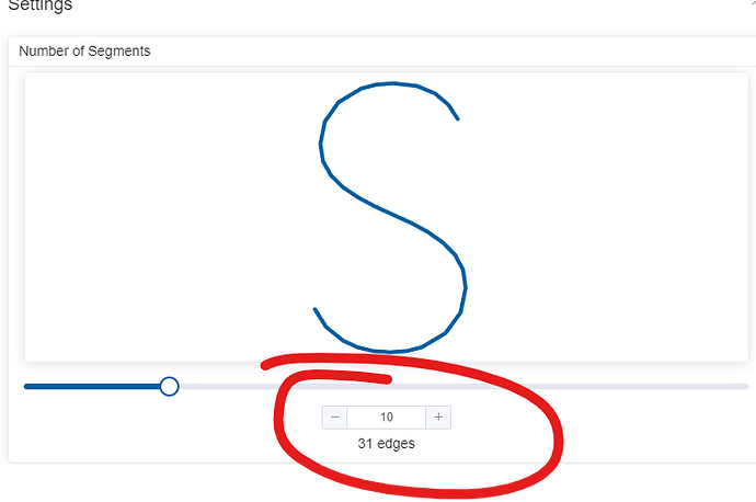

Do you think Curic Line is based on a regular font? It seems a bit more complicated, considering that in the Curic Line settings, you can change the number of segments to make them wavier.

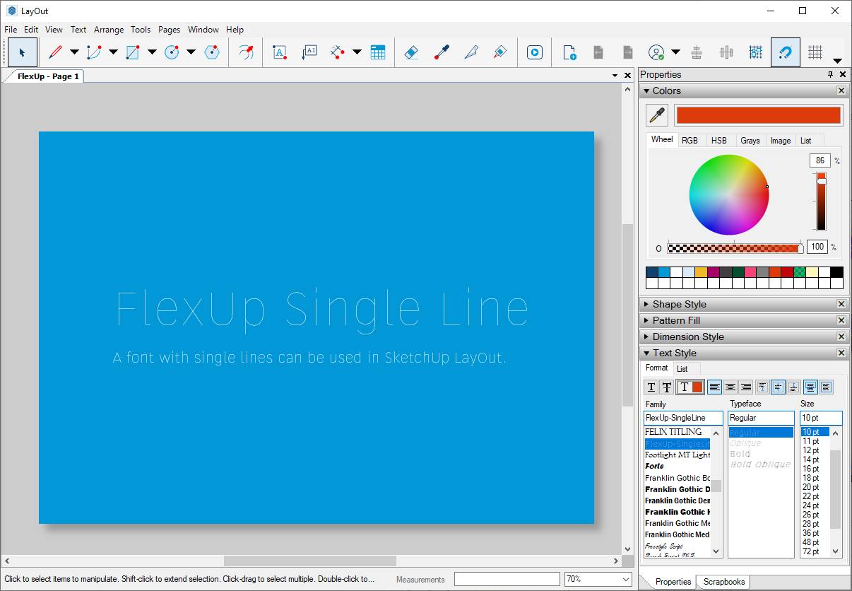

It’s me from FlexUp Team (new community on Facebook)
Anyway, here’s the credit for the font.
ā€œcopyrightā€: ā€œCopyright 2021 The Relief SingleLine Project Authors (GitHub - isdat-type/Relief-SingleLine: Single-line / open-paths sans serif font running in Adobe CC, Inkscape, Rhino and CAD softwares)ā€
