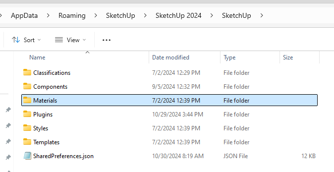

I cannot work out where the materials folder is located for my Sketchup models!

In newer versions of SketchUp, the native materials should be in Program Data. Typically custom materials would be in User/AppData/Roaming… That said, the SketchUp model file would include all the textures used in the model unless someone stripped them out before saving the file to send to you. There is no separate folder for the In Model materials.
If they removed the materials before sending you the file, you’ll need to reapply them. And if they are using custom materials, you would need to have those resident on your computer in order to apply them to the model.

FYI, at least in 2024, sketchup materials are found in \AppData\ Local \Temp, not roaming.
To get there from sketchup, right click the material icon in the materials selection tray. “edit texture image” will open the .png of the material. From there, you can open file location in your image viewer.

FYI, it’s not supposed to be there. The default location is in AppData\Roaming\ …
