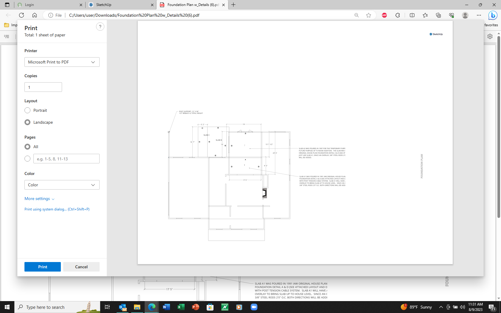

Screenshot in SU is below. Following is a screenshot of the “print to pdf” result.
In meantime, I’ll get the SU file where you may be able to see where the “operator” is the issue.
How are you using the PDF after you create it?
Will send to Office Depot for them to print “house plans” for submittal to county for building permit.
My plans include front, rear, L/R side elevations; framing plan with doors and windows, electrical, etc.
I basically have created multiple files but where I can I utilize one file with varying scenes and then print to pdf. I actually have an earlier pdf offload file that has the same text replicated in what appears to be 6 different “quadrants” on the pdf printout version.
