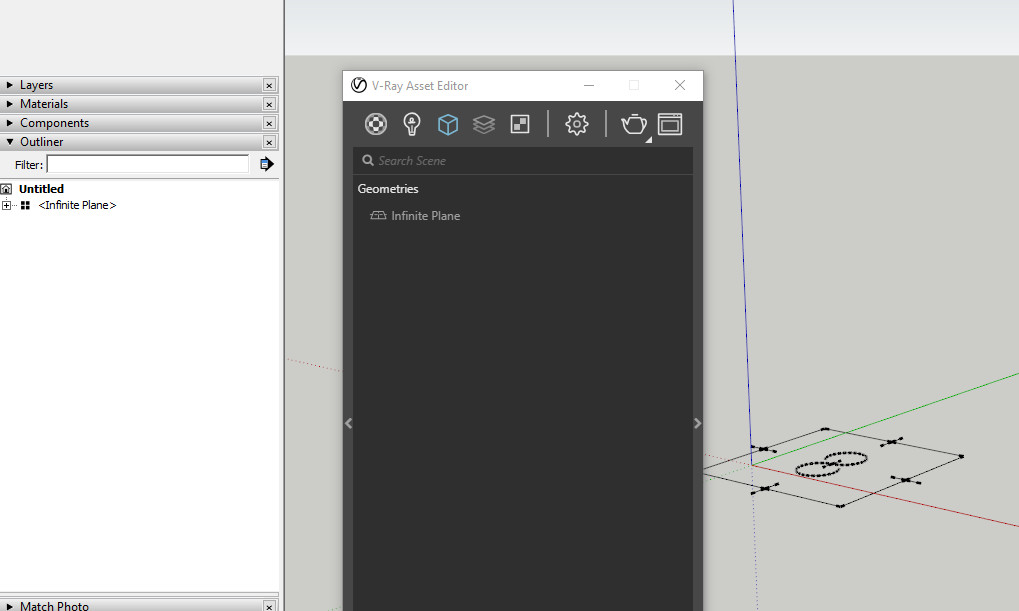

Strange plane appeared in my rendering that's blocking my ceiling and downlight, but i couldnt find nor delete it in my sketchup model
Hi guys, pleae help me out here. My rendering result doesn’t show the full model… (attached picture 1)
It looks like there’s a plane at 2.5m height that covers anything above 2.5m thus my light and ceiling doesnt show up in the scene. I’ve tried to reinstall vray, copy and paste the scene in a new sketchup document but it didnt work. and there’s no plane or objects that covers that area (I’ve unhide everything). Any suggestion will be very helpful. thanks…

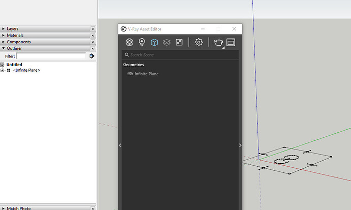

Search in V-ray or Outliner for a ‘Infinite Plane’.
omg! it worked!!! thank you so much for the fast response and the solution! :laughing:
