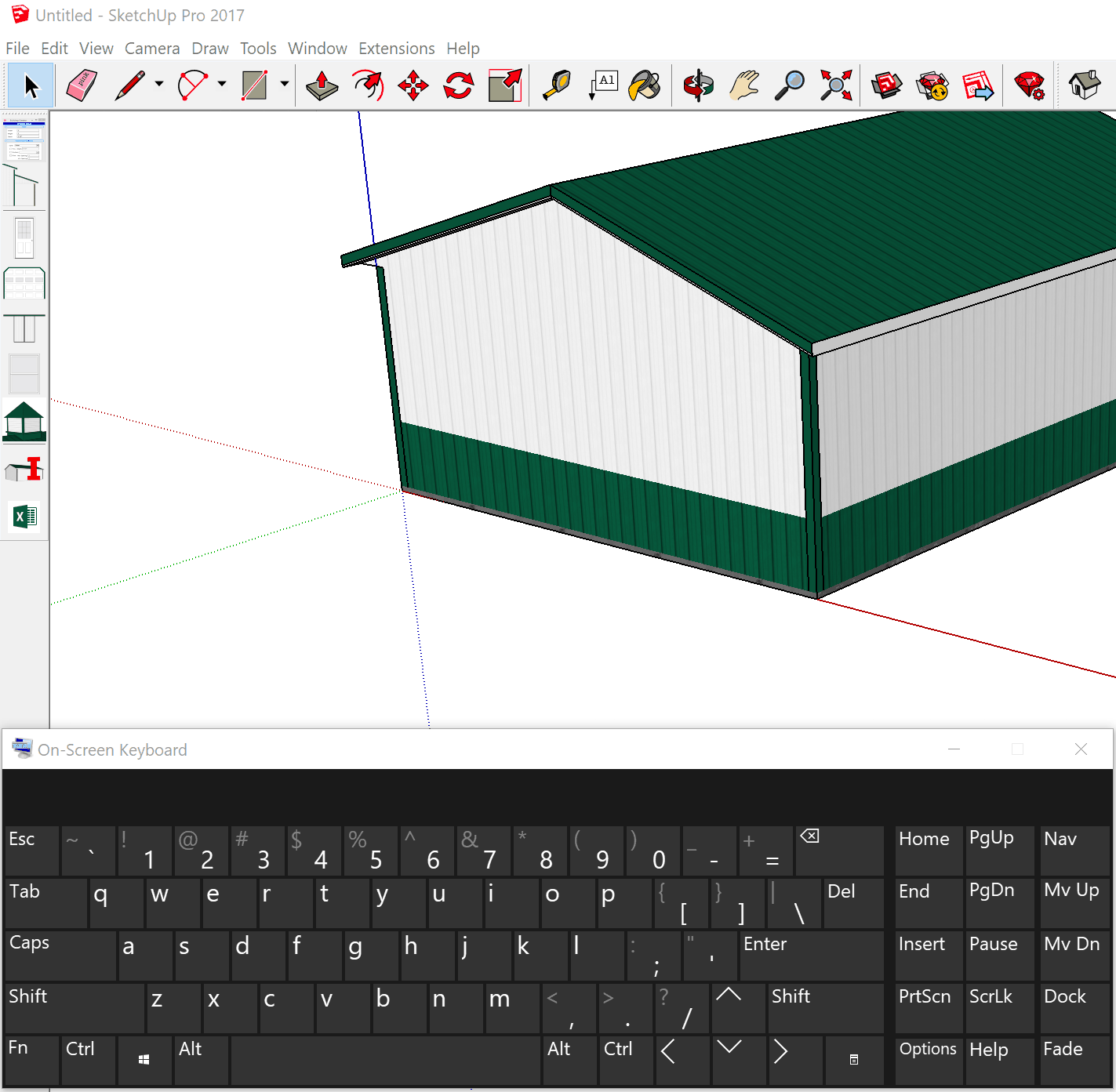

My Building Creator Extension actually uses only SketchUp tools and I must confess I’ve actually never written a tool. In my Building Creator extension I have a Draw Porch command. This activates the rectangle tool to draw the floor plan. After the rectangle is drawn I automatically draw the porch from that, and select the finished component. After that I activate the select tool, because for this work flow it is more common to select something after drawing the porch, than the rare case of needing to immediately draw a second porch.

I did have new users sometime tell me they couldn’t figure out how to get the line tool to ‘stop’. Simply press the big space bar and in their eyes the line tool ‘went away’. I’ve seen new users view the activation of the select tool as ‘quitting the drawing tool’.
For myself I still consider the select tool as a sort of default tool separate from drawing tools. Perhaps it’s because it’s the default tool when SketchUp starts.

In SU it is impossible to have no tool activated (from a developer’s view point), but if a user would tell me ‘I don’t have any tool active’ (incorrect) I would assume (perhaps incorrectly?) that the select tool is active.
